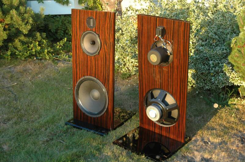

Komercyjna wersja odgród na nowych głośnikach. Capilano Audio Tyee.
"Capilano Audio's new Tyee dipole combines a Supravox 215 field coil driver as dedicated midrange with an Aurum Cantus ribbon and either a Supravox 400 field coil woofer or Capilano's new proprietary bass driver which has an Fs of .25, Qts of .6 and 96dB sensitivity. A Phil Marchand of Marchand Electronics designed and built proprietary 50-watt bass amp/equalizer actively drives the woofer and allows 50 - 150Hz low-pass adjustments as well as up to 6dB of boost at or below the 6dB roll-off for a claimed flat response to 23Hz. $8,995 takes home a pair."
I jeszcze link do strony producenta:
