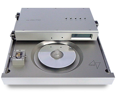

Na stronie 47 Labs jest opis wyjasniajacy ich podejscie do sprawy:
"Full-hard-suspention system:
The platform/casing of Flatfish is a 2/3 inch thick, machined aluminum board. All the driving mechanisms, pick-up mechanisms and the circuits are directly mounted on this one piece of aluminum board.
The huge difference between the mass of the mechanisms and that of the platform (150g against 1200g) enables to cut off the vibrations caused by the slight off-centering of the disks and the tracing mechanisms returning to the bit-tracing lens itself, allowing us to minimize the amount of servo control dramatically.
This rigid and compact structure of the platform has a very small surface area to receive the vibrations, and its large mass helps to reduce the vibrations smoothly and effectively without any extra damping or suspensions.
As a result, storage of vibration energy was minimized, letting us achieve a refreshingly quick transient response. Compared to the conventional box-type chassis/casings, this platform is almost completely free from any stress of construction. Now, you can hear how much harmony and bottom-end information was obscured under those mechanical stresses.
The design priority of Flatfish went straight into the new Shigaraki transport. In combination with the Shigaraki DAC, the performance comes so close to its aclaimed big brother, Flatfish-Progression:
Full-hard suspension system: the drive mechanism, the lens-actuator assembly and the circuit board are firmly attached to the sub-chassis. In combination with the Shigaraki ceramic base, the rigid structure ensures the fast and smooth release of resonance.
An extremely simple digital output circuitry to release the digital signals from any stress. "
Poza tym, gosc ktory poswieca 12 lat na opracowanie bezkompromisowego transportu chyba jednak cos wie na ten temat:

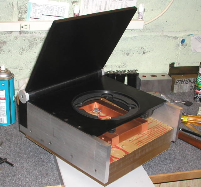

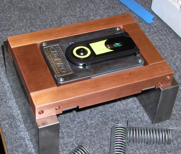

Osobiscie nie wyciagam zadnych wnioslow jesli czegos nie sprawdze personalnie. Jak juz wspomnilem wczesniej mam dwa zestawy chassis, jeden sztywny, drugi miekki, i wykonam odpowiednie testy.
A może tak zmodyfikować CdPro2 na zdjęciu widac konda doczepionego pod spodem na płytce, Lektor Prime.

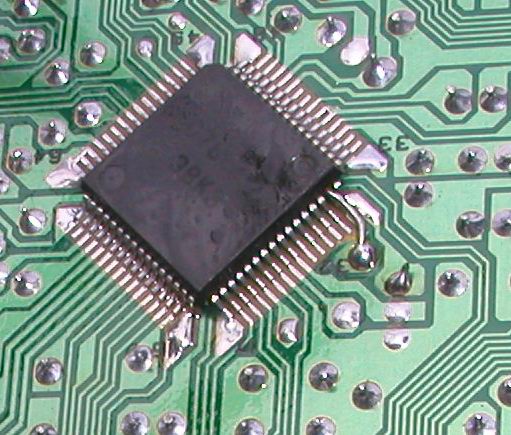

Małe conieco z budowy elektroniki:
SPDIF - oryginalnie nie był przewidywany w dawcy elektroniki więc Sakura odnalazł go w chipsecie i wyprowadził na zewnątrz. Wyjście zrealizowane po mistrzowsku - jak przystało na 47 labs - dolutowanym do scalaka od spodu 2 rezystorków - 200 ohm i 75 ohm do masy - sygnał zbierany z rezystorka 75 ohm.

Shigaraki i flatfish też nie miały. Ale każda kość Chipsetu takie wyjście ma - trzeba tylko znaleźć!
