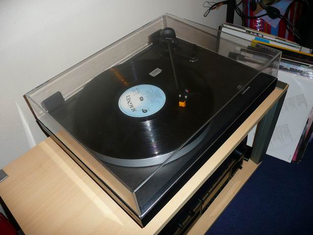

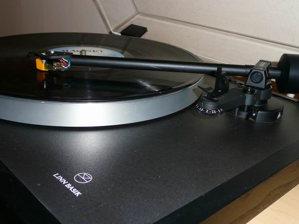

troche foto
https://www.audiostereo.pl/topic/36651-linn-basik/#findComment-882506
https://www.audiostereo.pl/topic/36651-linn-basik/#findComment-882508

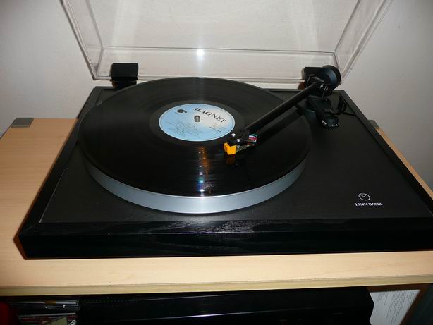

i fotka ;)
https://www.audiostereo.pl/topic/36651-linn-basik/#findComment-882705
