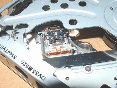

The new laser of KSS-660A, KSS-240A, VED0440, 3050, Alpine mechanism arrive
Please contact us if you are interested in it.
For other part number, please contact us directly
