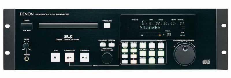

Od kilku lat pracuje na takim ustrojstwie:
product information
The DN-C680 represents the best of CD player technology developed by Denon
for studio and broadcast production applications, and makes a perfect match when
combined with the DN-M1050R MD recorder. Since its basic design is the same as
the DN-M1050R, the DN - C680 lends easily to the construction of a uniform
operating environment.
Highlights
- Index Search
- Auto Space
- Auto Edit
- Display of Playback Locations
- CD-R Reading Capability
Features
Index Search
The Select knob can be used to perform an Index Search when the INDEX button
is ON (the LED on the INDEX button lights up).
Auto Space
During playback, it is possible to insert a silent space of about 4 seconds
between tracks. To do this, simply press the AUTO SPACE button to ON
(the LED on the AUTO SPACE button lights up).
Auto Edit
This function automatically divides the total recorded time on the disc in half and
rearranges the tracks so that they fit neatly onto the A and B sides of a cassette
tape.
A bar graph display indicates playback points on the track being played. Elapsed
time and Remaining time displays are switched using the TIME button.
DN-C680 reads CD-R discs with or without Table Of Contents (Note: some CD-Rs
without TOC might not be readable)
19-inch Rack Mountable (Height: 3U)
Large FL Display, Illuminated Rubber Buttons
Track Search Select Knob (Easy track selection)
Jog Dial/Shuttle Wheel
Perform searches to 1 MD frame precision using the jog dial and easy scans
using the shuttle ring.
Program Play (Max. 25 tracks)
When the PLAY mode is set to Single, the player stands by at the beginning of
next track (at Finish mode "NEXT").
When the PLAY mode is set to Continuous, the playback is continued according
to your programmed sequence.
Play mode & Finish mode
Play mode
- Continuous: Play a whole disc
- Single: Play a track
- A-B: Play an A-B loop
Finish mode (Stop, Next, Recue)
- *only when Single Track play is selected
- Stop: Stops at the end of the track
- Next: Standby at the beginning of the next track after when the selected
track is played
- Recue: After the selected track has played, the unit will standby at the
beginning of that selected track
Auto Cue
After a track is selected, it is automatically cued to the point where audio starts.
Cueing takes place at the point where audio starts rather than where the track
starts. The level at which sound is first detected can be set between -36 to -72 dB
(7 steps).
End Monitor
Pressing the END MON button during standby instantly previews the end of the
track, thus assuring perfect "outros". The point at which monitoring starts can be
set within a range of 5 to 35 seconds (7 steps) prior to the tracks end.
End Of Message (EOM)
At the end of a track, the PLAY/PAUSE button flashes, providing a visual warning
to the operator that the track will end shortly. The point at which the flashing
begins can be set within a range of 0 to 30 seconds (7 steps) prior to the end of
the track.
Pitch Control (±9.9%, 0.1% step)
Instant Start (Playback starts less than 0.01 seconds after the PLAY button is
pressed.)
External Control Terminals
Serial Remote (RS-232C/RS-422A switchable, D-Sub 9-pin)
Parallel Remote (D-Sub 25-pin) optional RC-680 remote
Sampling Rate Convertor Unit: ACD-25FSC (Option)
Digital output is possible at 32 and 48 kHz as well as 44.1 kHz.
SMPTE Time Code Sync Unit: ACD-27CS (Option)
Conforming to IEC-461, LTC (Longitudinal Time Code) format
Time Code Chase Search
Video Sync or Word Sync is selected in Preset mode.M
The Word Sync signal supports 44.1 kHz ±1.0%.
Specifications
Type
- Rack Mountable CD Player
Audio Channel
- 2 channels (Playback: Stereo/Mono selectable)
Digital filter
- 18-bit 8-times oversampling
- Digital filter
D/A Converter
- Dual 18-bit linear
Sampling Frequency
- 44.1 kHz (32/48 kHz available using optional ACD-25FSC)
Total Harmonic Distortion
- ≤0.003%
S/N ratio
- ≥105 dB (A-weighted)
Channel Separation
- ≥100 dB
Frequency Response
- 5 Hz - 20 kHz ±1 dB
Analog output (1 kHz, 0 dB playback)
- Transfer and connector
- Balanced active, XLR connector *1
- Unbalanced, RCA connector
Output level
- Balanced: +18 dBm (±0.5 dBm), 600 ohm
- Unbalanced: 2 V, 10 kohm
Output level adj. range
- +22 dBs to -20 dBm (Balanced)
Headphone output
- 20 mW (30 to 40 ohm)
Digital output
Signal format
- AES/EBU or IEC-958 Type 2 or SPDIF
Output level
- Balanced: 3 Vp-p, 110 ohm
- Unbalanced: 0.5 Vp-p, 75 ohm
Serial Remote
- RS-232C/RS-422A (Switchable),
- D-Sub 9-pin
Parallel Remote
- D-Sub 25-pin for optional
- RC-680 remote
General
Power Supply
- AC 120V, 60 Hz
Power Consumption
- 19 W
Dimensions
- 483 (W) x 132 (H) x 297 (D) mm
- 19 (W) x 8.8 (H) x 11.7 (D) inches
Weight
- 6.5 kg (14.3 lbs)
Design and specifications are subject to change for improvement without notice.
12 month warranty

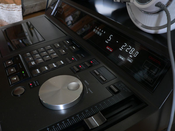

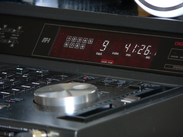

Jest jakiś urok w tym profesjonalnym sprzęcie-mój SL-P1200

> Całość pracuje w podwójnej klasie A-pełna kultura.
Zdajesz sobie sprawę, że "klasa AA" to wyłącznie wymysł marketingowców Technicsa, który na jakość dźwięku wpływa mniej więcej tak samo, jak kolor nóżek odtwarzacza?
Rozbawiła mnie ta "pełna kultura" ;) "Całość pracuje na nóżkach pomalowanych na srebrno - pełna kultura"... ROTFL ;)))
> Niektóre płyty zaczął czytać po przeczyszczeniu pastą regenerującą płytki.
Zamiast niszczyć płyty jakimiś pastami, zainteresuj się lepiej stanem lasera w odtwarzaczu. Czyszczenie i regulacja, jeżeli nie pomoze - szukaj zamiennika.
> Taka to już jest uroda zabytku.
Nie tyle "zabytku", ile po prostu większości starych CD.

Ulżyło wam i co teraz macie dłuższego a może ego wyższe ? a moze jedno i drugie ?
Żaden z was nie ma CD studyjnego a ten Technics był właśnie do tego zrobiony-choćby przyspieszanie i skracanie czasu utworu bez zauważalnej zmiany wysokości tonu-tym ostatnim często was częstują w radiu i nawet tego audiofilsko nie słyszycie a szkoda. To co wcześniej mówiłem że na innym CD (dotyczy rocha) nie słychać 20khz to prawda na tym starym moim sprzecie wszystko gra tak jak trzeba nawet z pogardzanej dziurki i napewno nie sa to podharmoniczne które jakoby było słychać w gorszym sprzęcie.
Kupcie sobie Studera 730,Tascama 601,lub w/w EMT lub coś co grało lub gra w radiofoniach, jak chcecie coś tutaj pisać;albo idzcie sobie do snobistycznego lampowego highendu i tam się niezdrowo podniecajcie.Ten sprzet służy do pracy w studiach i o takim sprzęcie proszę tutaj pisać

"Żaden z was nie ma CD studyjnego a ten Technics był właśnie do tego zrobiony-choćby przyspieszanie i
>skracanie czasu utworu"
Przepraszam, a po kiego grzyba mi to potrzebne?
Nie będę uruchamiał póki co dyskoteki czy stacji radiowej.
Póki co słucham od miesiąca stareńskiego Philipsa CD160 z NOS DAC w którym tuning polegał na na wyjęciu zbędnych elementów. Jest bardziej niż fajnie.
Rafael. Twój Technics kłóci się z moim minimalizmem.
