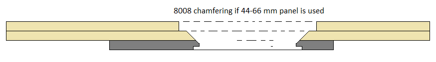

8 godzin temu, arczar napisał:
I zrób tunel za głośnikiem, który gra 750-1kHz, tak? Nie jestem pewien czy to dobry pomysł.
http://www.troelsgravesen.dk/chamfer.htm

You can make the panels much easier than mine. One-piece front + bass and mid extra panel, two rear support panels and two rear horizontal panels to keep things in place. And you can make them even better by gluing two 22 mm basic panels together to make 44-66 mm baffle thickness. Remember to chamfer 8008 driver hole accordingly! No need to chamfer bass hole. This driver is so big it has no trouble with proper ventilation.

Sławku, "As my rule of thumb, no un-braced box panel area should be larger than 4 inch squared for 3/4 inch thick wood panels. ", jak to rozumieć?
