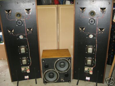

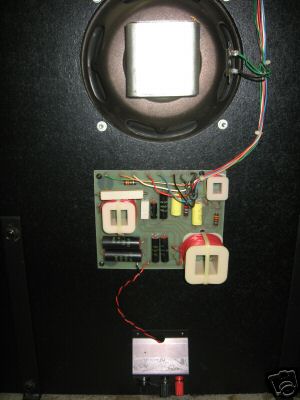

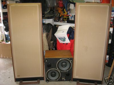

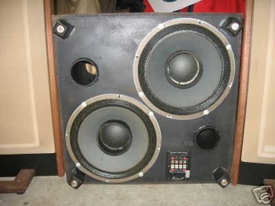

bardzo ciekawe odgrody Phase Linear:
PHASE LINEAR HISTORY WITH THE SUCCESS OF PHASE LINEAR'S AMPLIFIERS AND PRE-AMPLIFIERS AND AFTER THE MOVE TO THE COMPANY'S NEW BUILDING IN LYNNWOOD WASHINGTON IN 1974 BOB CARVER WANTED TO DESIGN A STEREO SPEAKER SYSTEM THAT,AS CLOSELY AS POSSIBLE,REPRODUCED THE ACTUAL LISTENING EXPERIENCE OF LISTENING TO LIVE MUSIC.CARVER HAD DEVOTED A GREAT DEAL OF THOUGHT AS TO WHY LIVE MUSIC SOUNDED THE WAY IT DID,AND HOW REPRODUCED MUSIC FAILED HAD DUPLICATE THE LIVE LISTENING ENVIRONMENT. LIVE MUSIC PLAYED IN A CONCERT HALL WAS THE AMBIANCE CARVER WANTED TO ACHIEVE. AFTER MOUNTHS OF ENGINEERING AND PROTOTYPES'CARVER FELT HE HAD REACHED HIS GOAL.THE FINAL SYSTEM WAS MADE UP OF TWO LARGE,24"X63"X5"SPEAKER PANELS, A SUDWOOFER MODULE AND AN ELECTRONIC MOTION CONTROL SYSTEM. THE SPEAKER PANELS EACH HELD TWO 8" MIDBASS DRIVERS,TWO 4"MIDRANGE DRIVERS FOUR 2"CONETWEETERS AND A 1"SOFT DOME TWEETER.THE SUBWOOFER MODULE HAD TWO FLOOR -FACING 12"BASS DRIVERS.THE FREQUENCY RESPONSE WAS 24Hz TO 20K Hz. THE ELECTRONIC MOTION CONTROL SYSTEM CONTAINED"SPATIAL IMAGING CIRCUITRY , FREQUENCY TAILORING AND TRANSIENT CONTROL EQUALIZATION,"ACCORDING TO THE MODEL 3 LOUDSPEAKER SYSTEM BROCURE.INITIALLY, THIS SPEAKER SYSTEM WAS INTRODUCED IN 1976 AS ANDROMEDA 3 BUT CARVER ENCOUNTERED A NAME DISPUTE,SO HE CHANGED THE NAME OF THE SYSTEM TO PHASE LINEAR 3 FOR 1977.WITH A LIST PRICE OF 1500 WHEN INTRODUCED IT AMAZED LISTENERS WHEN PLAYED IN PHASE LINEAR DEALER LISTENING ROOMS. THEY ARE IN GREAT SHAPE FOR THER AGE ONE OF THE MIDRANG DRIVERS HAS A RIP IN IT THATS ABOUT IT LOCAL PICKUP I LIVE IN HOWELL NJ 07731.
