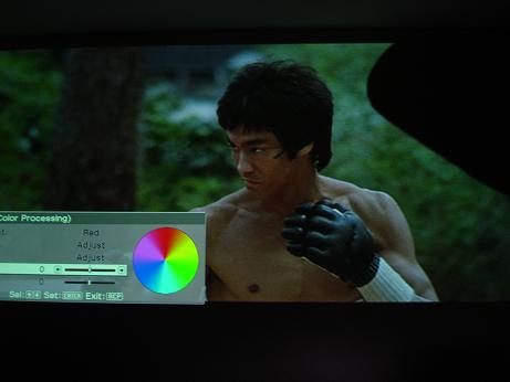

RCP (Real Color Processing): Real Color Processing allows the user to target specific colors on the picture and fine adjust their color and hue without changing the overall picture's color and hue. For instance, the color of a strawberry can be fine adjusted without impacting the skin tones. Or the blue in a sky can be adjusted without affecting the color of water. And green grass can be adjusted without influencing the other colors in the picture.
-> americano
Dzięki za zdjęcia. Ta punktowa korekcja, jeżeli działa tak jak napisano, jest bardzo ciekawym narzędziem.
