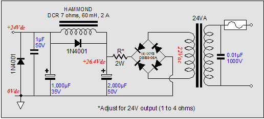

Witam, będę cytował za Johnem Broskie, którego lubię, że najlepiej dla brzmienia stosować szybkie diody Shotkiego plik zas1.png lub "spowalniane" 1n4001 (!!!) plik zas2.png, w żadnym razie nie mostki!
cytaty:
"Which rectifiers should be used? I recommend ultra-fast rectifiers, such as the popular HEXFREDs or the unpopular Schottky diodes. (Developed by International Rectifier, in the 1970s, “FRED” stands for Fast Recovery Epitaxial Diode, thus the trade name “HEXFRED.” Today, manufacturers include Harris, International Rectifier, IXYS and others. Tube folk do not know about Schottky diodes because, until recently, it was not possible to buy a high-voltage Schottky diode. But these fast rectifiers also make for cleaner power supplies.)"
"The worse choice, other than a WE275 rectifier (too much current draw), is the cheap and ubiquitous 1N4001. This rectifier works well in many non-audio applications, but it spurs too much switching-induced noise into an audio power supply. Still I know that many readers will opt for them, as they already own several dozen. If you insist on using them, then build the circuit below. Paradoxically, the added capacitors actually slow the diodes, while the 0.22-ohm resistors help soften the transitions between conduction and non-conduction. And the choke filters away the ripple."
