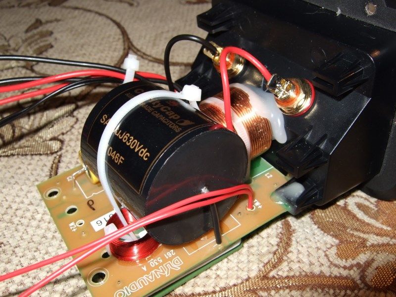

Brzmienie zapewne by się poprawiło po zmianie kondensatorów (są zwykłe SCR) i rezystorów drutowych (elementy indukcyjne) tworzących filtr górnoprzepustowy tweetera, ale pojawiłby się problem z ewentualną odsprzedażą. Im wyższa seria tym zysk z modyfikacji powinien być mniejszy, obudowy są lepiej dopracowane a to ma ogromne znaczenie!
Tu jest zdjęcie zwrotnicy z contour s1.4:
http://www.hifi.nl/recensies/2999/Dynaudio-Contour-S1-4.html
Na stronie:
http://www.tnt-audio.com/accessories/claritycap_e.html
jest taki opis brzmienia po zastosowaniu clarity cap SA (te co u mnie, na zdjęciu wyżej) w Dynaudio Contour 1.8 mk2:
"Strangely enough I didn't notice an immediate improvement, like with the amplifier. The overall tonal balance of my speakers was the same as before. I did notice a slightly more spacious soundstage and sweeter highs, but I have to admit that the difference wasn't enormous. But then, during the next weeks, I found myself listening to music even more than usual. And, it seemed as if my speakers were getting more and more detailed too. There was certainly a crispness to the treble that wasn't there before and, again, it didn't come at the expense of musicality at all. If anything, the sound of my speakers is now easier on the ear than before, while at the same time having higher resolution and clarity. Focus was improved too, with images between the speakers being a bit more solid and stable, and better 'corner-fill' behind the speakers. Soundstage is slightly larger in all dimensions. Strangely enough the bass is now a bit stronger and the midrange is clearly a bit fuller, while overall tonal balance is as neutral as before (read: as neutral as my room). In addition to this, the sound is now less attached to the speakers, with only really nasty sibilant noises having the tendency to come from the tweeters, but everything else originating from somewhere in the soundstage. "
Ps. W Contour 1.8 mk2, contour s1.4 i w excite x16 jest ten sam tweeter.

Posłuchałem jakiś czas i pokrótce napiszę jak gra po modyfikacji.
W pełni się zgadzam z tym co napisał kolega Włoch na TNT-audio. Po pierwszym odpaleniu szału nie było, jednakże po kilkudziesięciu godzinach grania rezultat jest:) Najbardziej oczywistym testem jest to, że płyty, które wcześniej denerwowały mnie ze względu na nadmierną (wtedy) ilość wysokich tonów teraz grają wspaniale! I nie jest tak, że wysokich jest mniej, ilościowo jest ich tyle samo, ale są jeszcze bardziej szczegółowe, dłużej wybrzmiewają a przy tym zupełnie nie drażnią. Wokale są świetne.
Kolega, który był dziś u mnie na odsłuchach od razu stwierdził, że gra lepiej, bardziej wciąga i poprawiła się scena. Coś musi być na rzeczy;)
Co zostało zrobione:
1. wkleiłem trochę mat bitumicznych, uprzedzając pytania - w niezauważalny sposób zmienia to strojenie BR. Dzięki temu obudowa wyraźnie mniej drga podczas grania. Efekt - wyraźniejsza średnica i bas, mniej "rozmyć".
2. na dolnej ściance i za wooferem dałem gąbkę falistą (polink) zamiast zwykłej, zastosowanej oryginalnie. Jeżeli w oryginale powstawały rezonanse góra - dół to teraz mają trudniej;)
3. kondensator tworzący filtr woofera zmieniłem na clarity cap 10u a rezystory w szeregu wymieniłem na bezindukcyjne.
4. kable do płytki zwrotnicy i od zwrotnicy wymieniłem na solid core 6N, pominąłem wsuwki. Na tweeter - po dwie żyły 0,5mm2, na woofery po dwie 1mm2.
5. wytłumienie miękkie pozostawiłem bez zmian. Sztuczna wełna zastosowana w oryginale jest wysokiej jakości.

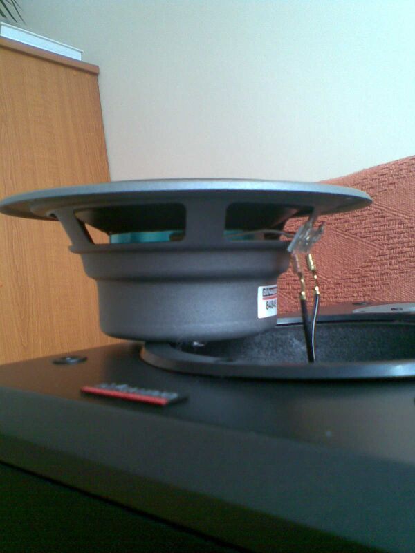

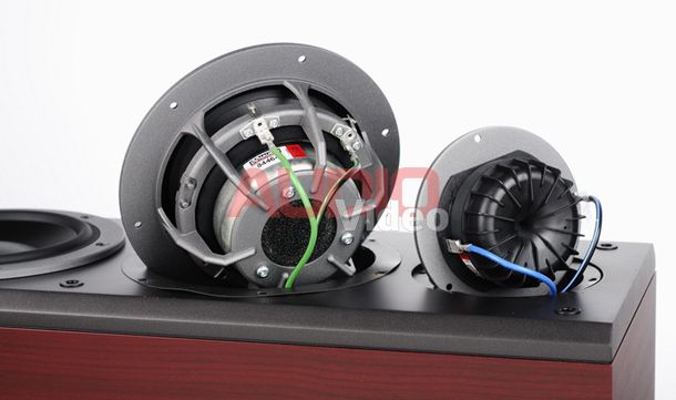

Witam szanowne grono W nowym av ukazał się test Dynaudio DM 3/7 zastanawia mnie dlaczego w modelu 2/7 jest woofer z koszem blaszanym a już w modelu 3/7 zastosowali woofer z koszem odlewanym a przecież to ta sama seria DM i ta sama wielkość głośników. Czyżby oszczędności..?, szkoda. Pozdrawiam.
Niestety to jest właśnie oszczędność.
W tych nowych dm3/7 jak na cenę niewiele ponad 4kzł zastosowali wyjątkowe głośniki: woofery wyglądają jak te z focus 220 a tweeter jak mój esotec. W tańszych i mniejszych modelach DM stosują inny tweeter - pewnie nie wyrabiał mocowo z dwoma wooferami i musieli dać coś lepszego...
