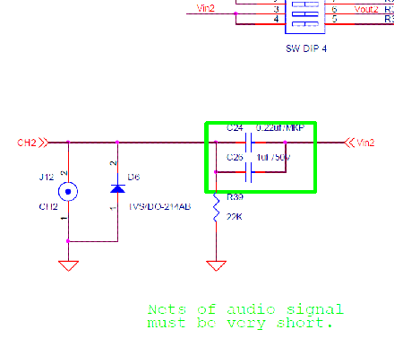

Najgorsze że bez schematu nie wiadomo co się wywala. A jak nie wiadomo co to też nie wiadomo dlaczego.
A gdzie można dostać i jakie wartości wsadzałeś? Według noty powinien siedzieć 2.2u na wejściu.
Podobno powinno się też zewrzeć diody na zasilaniu. Zabezpieczają przed odwrotną polaryzacją zasilania ale przy skokach prądu pulsuje na nich napięcie.

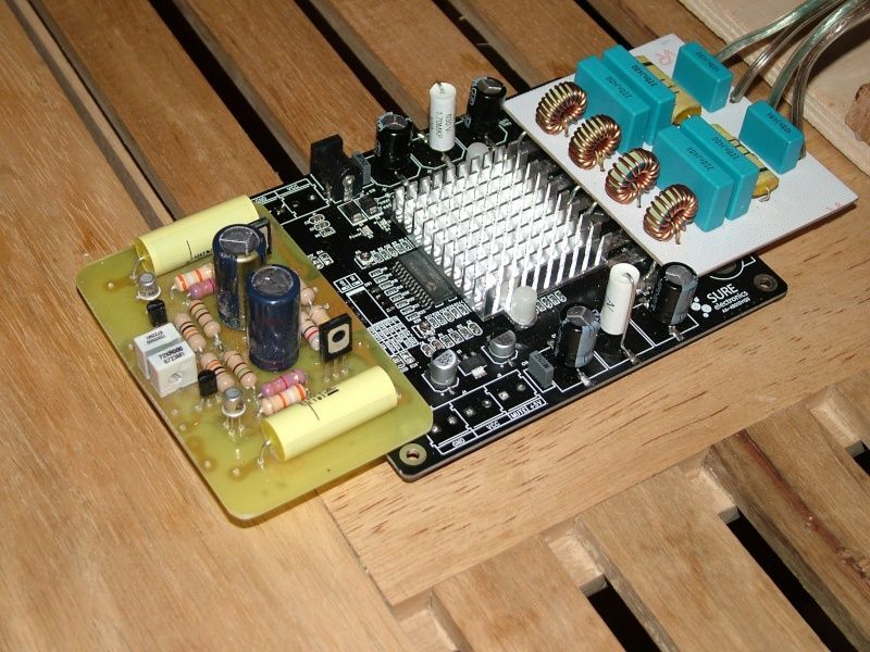

have some spare time while I wait for the new sure board to replace the one I scorched. So I completed the list of mods and things around the board I did. Maybe you find that interesting.
PSU Mean Well 24/145:
- cranked up to almost 30V
- 0.47uF MKS btn GND and COM
Sure board:
- changed PCB traces per audio1st suggestions (
- removed D1,2
- added 0.1uF parallel to C6 from the underside of the board
- exchanged C22&27 for 470pF as per the TC2000 data sheet
- re-wired pins 24 on both TP2050s to 21,22 (Vdd) instead of gnd
- removed tank caps from rails and replaced with 2 x 2 Panasonic FM 1800uF/35V on the rails
- replaced C3 with same type Pana FC
- added 0.1uF/100V MKP4 parallel to C3
- replaced C4 with standard-middle-of-the-road cap 100uF/10V
- replaced R2 with 2 green low-current LEDs, V_F=2.0V
- replaced R3 with 470Ohm
- added diodes 1n4001 btn Vadj/Vout and Vin/Vout
- replaced output filter
12uH self-wound toroids: T68-2 with 46 windings of 0.6mm enameled wire, sets of 2 plain windings followed by 1 clove hitch to double up the wire layer on the inner perimeter of the toroid
.47 uF/250V MKP4 as common mode capacitors
.22uF/630V MKP4 (had those in the box) as differential mode capacitor
.22uF/250V MKP4 as Zobel capacitor
10 Ohm/1W Metal Oxide as Zobel resistor
- replaced R16,30 with 22kOhm metal film
- interrupted traces btn input RCA and screw terminal
- removed R11,27 and replaced with 22kOhm metal film connected btn old solder pad and screw terminal
- removed R4 to open loop over SignalGND, Earth and B1
- added modified Pass B1 buffer (
Zaloguj się, aby zobaczyć treść (możliwe logowanie za pomocą ) ) to input
- 1nF/1000V MKP4 from speaker terminals to chassis
B1 specs
- R1 2.4 Ohm
- C1,2 2 x 3 x 3800uF/35V Panasonic FC
- C3 1uF MKP-10
- Cx00: 1uF MKP-10
- Cx01: 2.2uF MKP-10, directly linked to input resistor of sure board
- Rx05,x05: dropped
- 50k Vishay conductive plastic, log taper
- added 1N5401 to input of positive rail, bypassed by a 1k resistor for a controlled discharge of the caps (otherwise the sure amp makes an ugly noise when going down)
