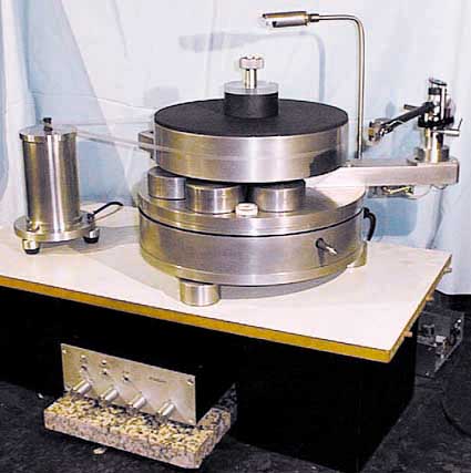

The skating force pulls the arm toward the disc center, this force is is not constant, but it decreases toward the disc center. Standard antiskating produce a constant force only, the pressure of the stylus on the two groove walls can be balanced only in one point of the disc, this means that in all other points the pressure is not balanced, the antiskating force is not correct, and mistraking occurs, causing noticeable distortion. My magnet displacement (copyrighted) is shown in the drawing, there are 4 Alnico magnets. This is the first antiskating in which the magnets can be adjusted to reduce the antiskating correction with the same ratio as the skate force is decreasing, the stylus pressure on the two groove walls can be balanced from the beginning to the end of the disc. The stereo image is focused and stable and the distortion low as never previously experienced. In the past the only example of unipivot tonearm with magnetic antiskating was the Decca International arm, but the magnetic antiskating was not ajustable as in in my tonearm. Some time after my tonearm presentation, other manufacturers introduced unipivot tonearms with magnetic antiskating, but to avoid law prosecution they do not copy exactly my magnet displacement, and they do not claim their antiskating with a decrasing force to the disc center. My pirates change something, employing other displacements not so fuctional and adjustable like my original arm.. Sorry: it is the previlege of Originals to be plagiarized. To adjust the antiskating an”antiskating test disc” is supplied with the tonearm. The instruction manual is exhaustive with many drawings.

W ogóle to gość robi(ł?) bardzo ciekawe konstrukcje mimo warunków DIY, co widać po półce na zdjęciu,
