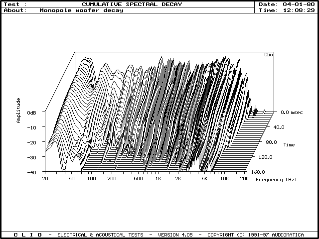

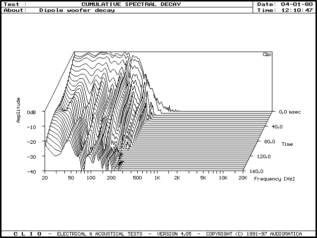

I have one from the dipole setup yes. Woofers only.
The first "ridge" is the speakers alone, and the later and lower in level is the room decay.
It does not look like this at all with monopoles, and there is only one decay "ridge"
Monopole response in the same room. Different speaker and no EQ, but it shows how the decay behaves differently than with dipoles.
