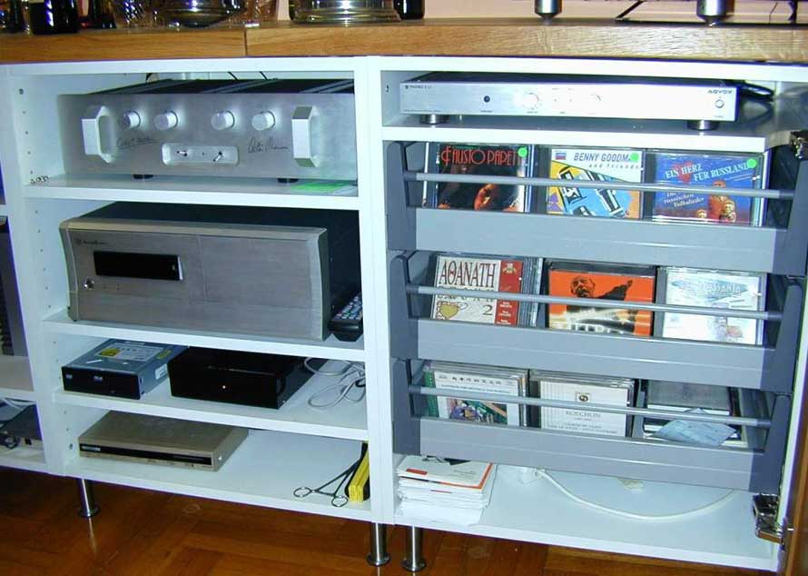

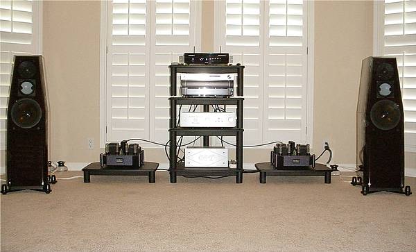

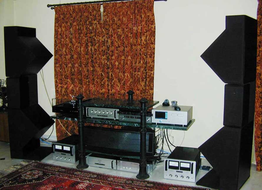

Trzy systemy z komuterowym źródłem:
1.
Kharma Ceramique 2.1 w/SDSS
Manley Laboratories Snapper!
ModWright SWL 9.0SE Signature
Audiomeca Enkianthus.X
Panasonic DVD-XP50
HTPC Audio/Jukebox
2.
Opera reference LP-5.0
PC Audio with Lynx sound card.
Plinius 12 custom edition
Quad 909 150wpc
Quad 988 Vintage electrostats
3.
Goldmund Studio
HT PC w/7" touch screen
Audio Research SP10
2 x Audio Research VT150
B&W 800 Matrix
