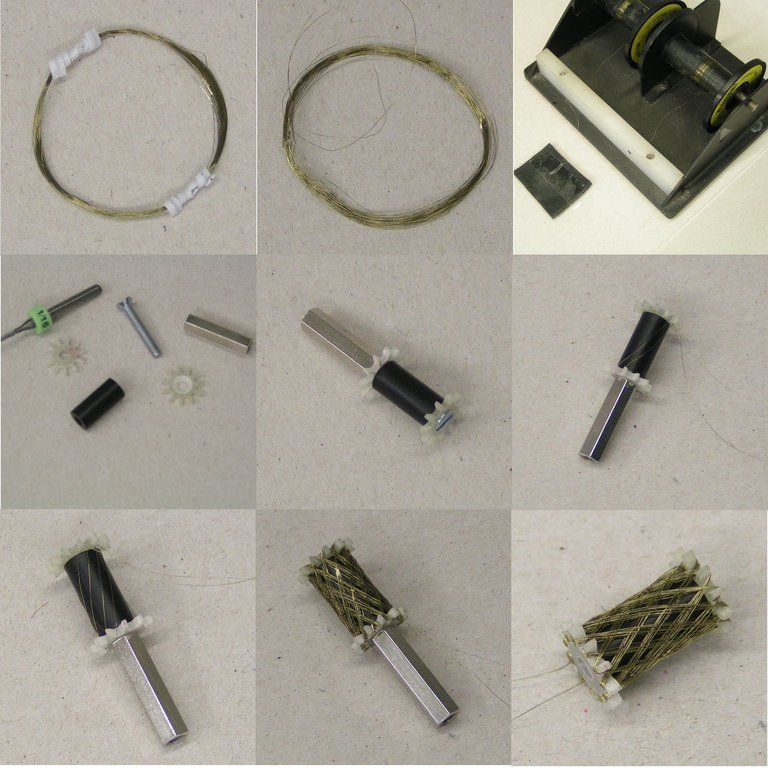

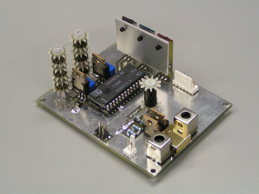

" I only use Honeycomb Mobius construction for both, wire wound resistors and Mobius loops. The Mobius loops (same construction but using copper wire) help to clean up the signal in highly critical signal paths by manipulating the flow of electrical charge. The Honeycomb Mobius resistors already have this property.
The latest TDA1541A-MK6 prototype has multi-segment Honeycomb Mobius construction to further reduce self capacitance.
The resistors are made out of thin insulated resistance wire. I mainly use 63 Ohms / meter and 100 Ohms / meter. So a 500 Ohm I/V resistor would require 5 meters of 100 Ohm / meter resistance wire.
The resistor is made non-inductive by folding the wire half way in order to make a Mobius loop. This way the magnetic fields created around each wire are canceled, reducing inductance to almost zero. You could basically fold the wire, twist it using a hand drill and wind it on a former.
But wire wound resistors also have self capacitance. In order to minimize this self capacitance, winding methods can be used that either increase the distance between the wires, or minimize the surface area where the wires cross. Suitable winding method for this is the honeycomb winding pattern. The distance between parallel wires is increased to the wire diameter and the area where the wires cross is also minimized.
The latest experimental version is a multi-segment Honeycomb construction where the self capacitance of each segment is reduced by factor 3. Example, if each segment has 30pF stray capacitance, then the 3-segment assembly offers 10pF stray capacitance, this is caused by series connection of the stray capacitances. These resistors are difficult to construct, as the 3 separate windings must be made with one un-interrupted piece of resistance wire. markings are placed on 1/3 and 2/3 of the folded wire length to indicate when to move to the next segment. I attached a photograph of 3-segment Honeycomb Mobius resistors used in the latest TDA1541A-MK6 module.
In order to create a honeycomb pattern we need discs with an odd number of petals, I use 11 petals. I constructed the frame from 2 pieces of CNC milled PCB material and a 15mm plastic spacer.
I attached a second picture illustrating the winding process. I get the wire in 5 meter lengths, first I solder both wire ends and measure if the resistance is 500 Ohms or higher. This prevents frustration when the resistor is completed and the measured value turns out to be too low. For achieving maximum performance it is important to use one single un-interrupted wire.
Double spool holder ensures the wire doesn't get entangled during winding, so one can fully concentrate on the winding process. I made it from aluminum parts and two empty copper wire spools. The wires are guided using a white nylon plastic block with two small holes drilled in it.
One end of the wire is fixated to spool #1 using sellotape. The wire end is folded back over the tape so it won't slip through when wire tension increases. The wire is carefully wound on spool #1. Next the other end is fixated to spool #2 in a similar way.
The wire is then pulled off the spool and the end of the loop (2.5 meters) is fixated to a counterweight (I use rubber sheet). This counter weight keeps tension on the wires when winding the wire back on both spools. When ready we have same wire length on both spools.
Next the honeycomb frame is fixated using a M3 screw and a hexagonal brass spacer as illustrated.
The fold is placed on a lower petal (disc closest to the brass spacer). Then both wire ends are wound on the frame, skipping 3 petals every time.
When completed both wire ends are temporarily fixated to the frame by winding it around the petals. The frame is now self supporting so the screw and hexagonal spacer can now be removed.
Now the resistance value can be fine-tuned by cutting off pieces of wire. In this example every cm of wire corresponds to 1 Ohm resistance. Both wires must have same length, so when cutting 1cm off one wire, the same has to be done with the other. After soldering the wire ends, the resistance can be re-checked. This process is repeated until the resistor value is correct.
